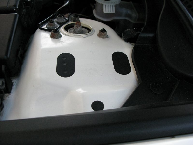

First I took a long look at where I should put my condenser unit. My TSX is bone stock just got it 2 weeks ago

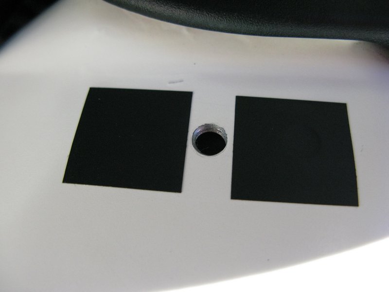

I decided on the driver's side area. Looks bare and I notice there are covered holes.

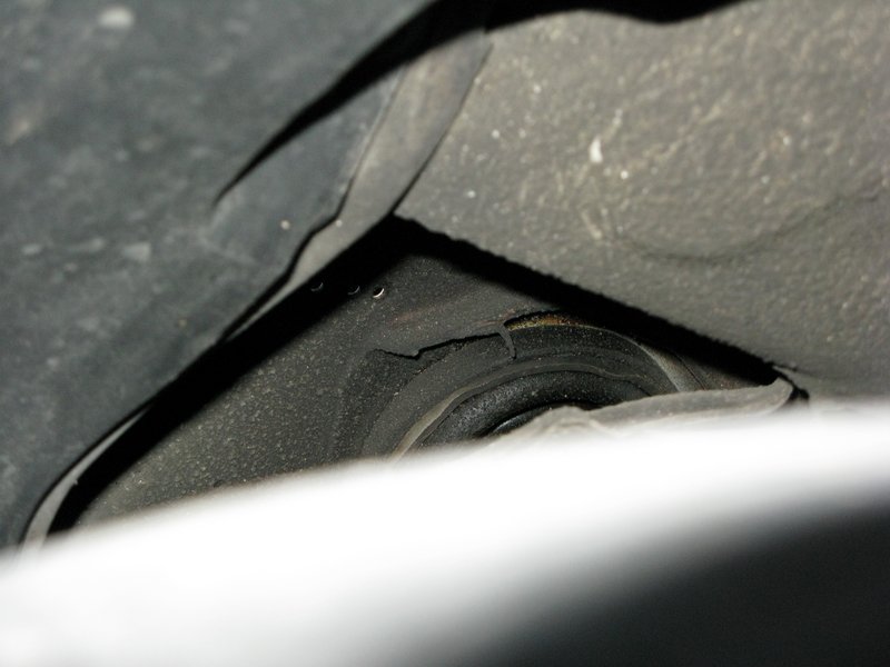

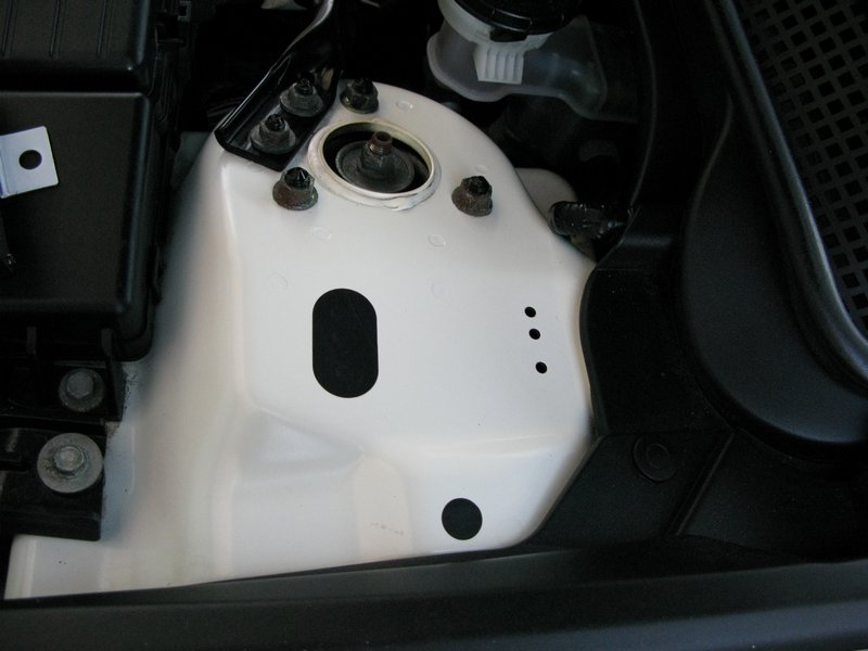

When I removed the tape its just 3 holes.
Under they go nowhere and there is good clearance.
You need a taper set and a M6X1.0 taper
Tapered at M6X1.0 and taped up the other holes with electrical tape.

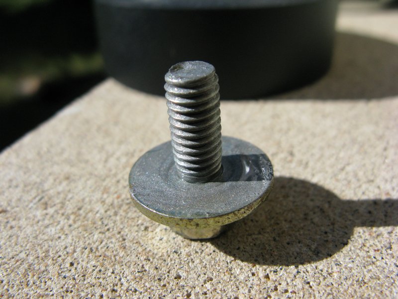

Took a standard M6 Honda bolt and put anti-seize on it.

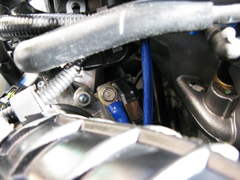

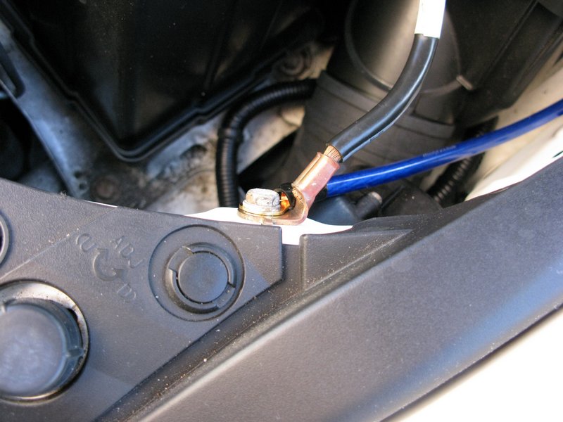

The main negative terminal from the condenser I mounted it with the main battery negative terminal.
I grounded the throttle body and Intake Manifold.
Ground some random open bolt hole on the tranny.

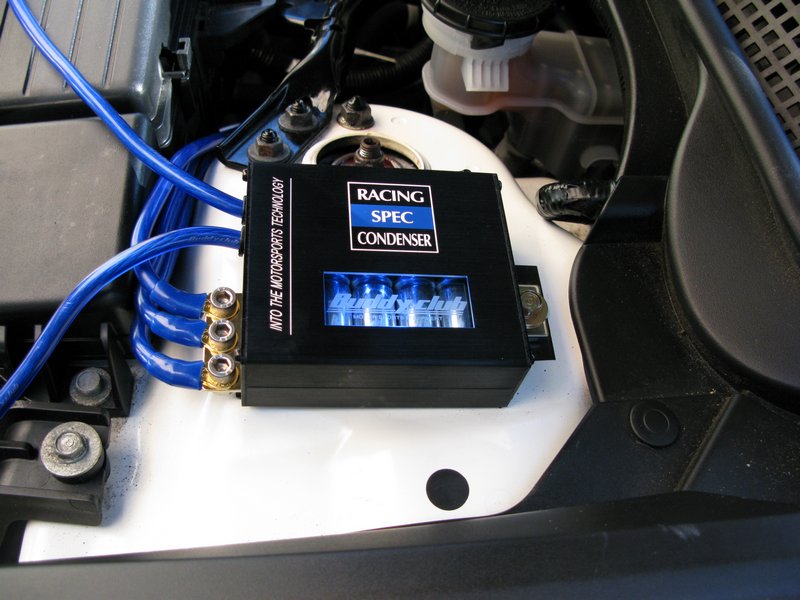

Lastly you connect the main positive from the Buddy Condenser to the positive of the battery. Then you're done!
This is what she looks like at the end! Engine bling!
