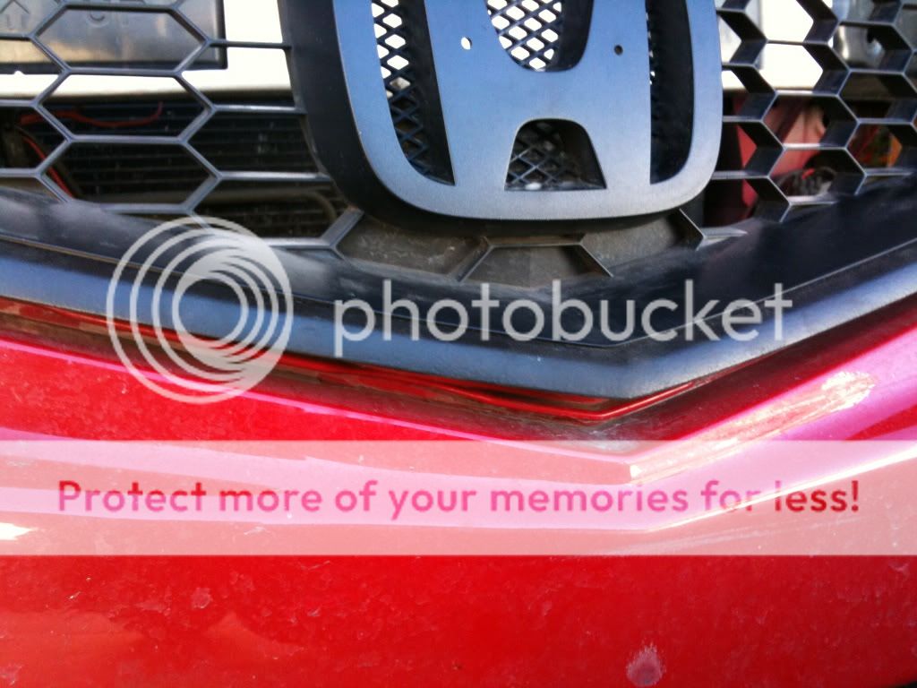

Did I do something wrong or something I'm missing here? or Does the Euro R grill 05 are not meant to fit OEM bumpers? :confused:

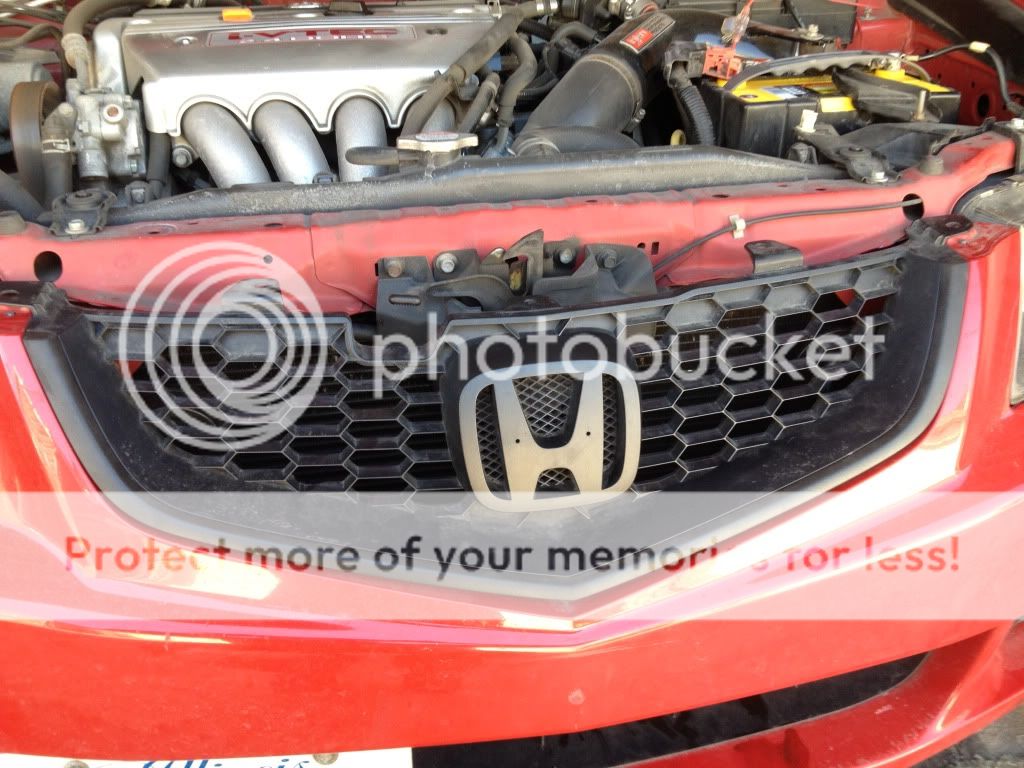

heres a full picture, btw if you guys didn't notice, the grill sit on top of the bumper as you can tell from the holes right by the headlights on either side (not sure if this is correct)

It's because of the shape of the bumper. We all have that problem, and it only affects the 04-05 model. Zip-tying is the only solution, and it won't completely take care of it.
The gap is much more noticeable on lighter cars than on darker. There's been much discussion on this. Look around and you'll find tons of material.
I love my CL9!
4,068 Posts
This is a well documented issue. The 04/05 JDM/EDM grilles and bumpers are slightly different causing this gap. You can try to use zip ties but the only real way to get rid of it is to get a JDM/EDM bumper.
