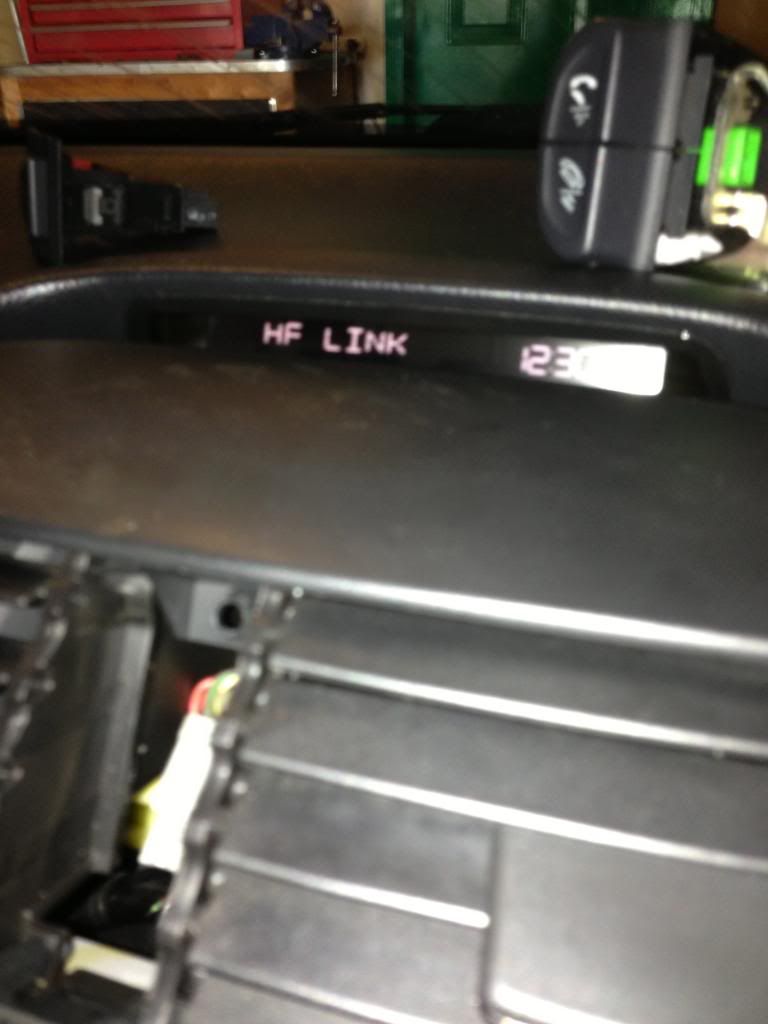

Powered up and greeted with the wonderful splash screen!
Handsfree link working
