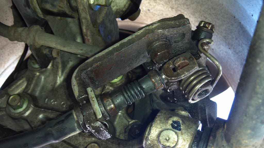

So upon further investigation...it seems that one of my ebrake cables is stuck. I guess I have to change the cable itself. Here's a pic of what it looks like:
And under the center console:
Any DIY on changinging this cable?
