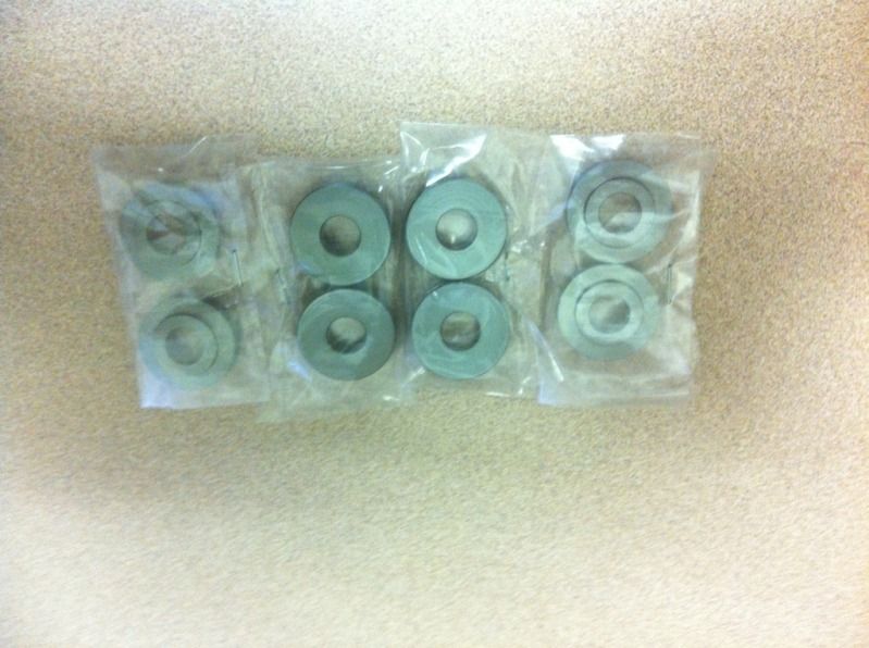

Install
I’m not going into a full DIY when it comes to installing these parts, but will go into a simple detail on how it’s done. Let’s start off by removing the center console. You need to stick your finger under the eBrake hole and pull up with some force, but slowly. Once the back peace pops out you can start to pull the rest of it up. This is what it should look like thus far.
Next you will need to remove the rest of the center console. This will be done by taking the rubber mat out of the bottom of the arm rest and remove all 3 screws. There will be 2 more screws right behind the shifter and those will need to be removed as well. Next there will be two screws under the “Not an Ashtray” cubby that need to be taken out. Do not mistake these for the screws that hold the cubby in. So after all those screws are out you should have nothing but some wires, and the shifter box sitting on the center on the car. It should look something like this.
Next, you need to remove the little bracket that is located right behind the shifter box. There will be two cables coming from the shifter box itself. On the right of the shifter box you will need to remove the cotter pin, and take it off the shifter box. Just a few inches up you will need to turn the plastic peace 90 degrees and pull up, the cable will be released from the shifter box. After that, remove the four bolts from the shifter box, and pry the “U” clip off of the second cable located in the middle/front of the shifter box. Fallowing that, you will need to get the “U” pin off located inside the shifter box that connects the shifter cable to the shifter. After you remove that you would be able to lift the box, and all out of the car.
I used a clamp to hold the shifter box down so I can work on the underside. You will need to pry the little plastic ball off the bottom of the shifter poll. Make sure you don’t lose this as you will need it soon. After you take the Plastic ball off you can put the included LocTight on the bottom of the stock shifter stick and put the CT Short Shifter on top of it till it’s sitting all the way down, and put the plastic ball back on top of the CT Short Shifter.
After that, you are all finished with install the CT Short shifter. Reinstall everything as it was taken out and you will be all done. Enjoy!
This next part is for the people who bought the CorSport Shifter Base Bushings.Simple push the metal washer that’s located inside the rubber washer out so the 4 bolt holes are empty. Get your 8 shifter bushings out and get ready to the shifter box install. Set the box down and match it up with the 4 holes. Put one metal washer under each hole, and then put one washer on top of each hole. Put the bolt in and tighten it down. It’s as simple as that!
Yay, the easy part because I am soooo tired of typing!!!!!
Hybrid Racing Shifter Bushing Install!!
Here are some pictures of the process….
