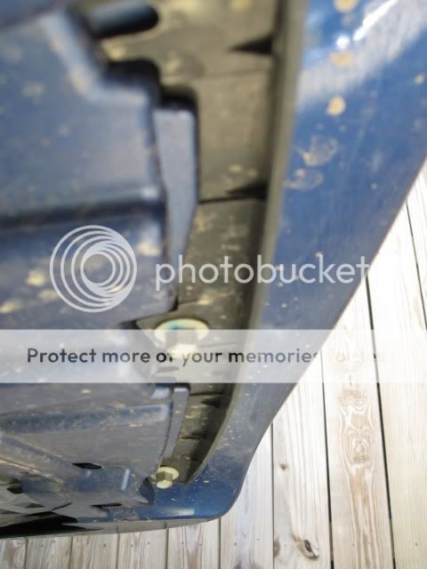

3) Remove bolts under the bumper (10mm socket) and trim clips. Every single bolt and clip pictured needs to be removed. It should be all of them I have shown in the pictures. I keep the bolts in the same order as I removed them and how they sit on the car. Just to be sure I know which ones go where when I put it all back together.
Bolts:
Trim Clips:
