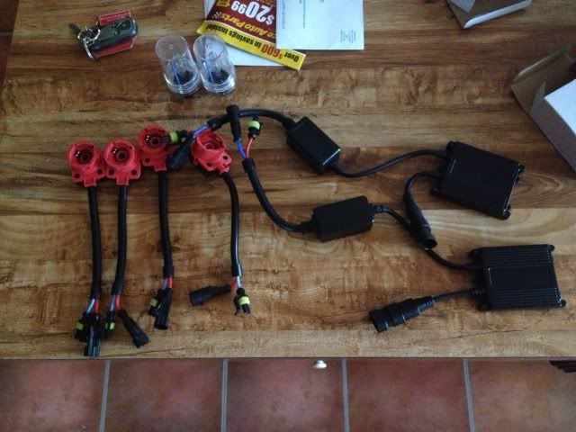

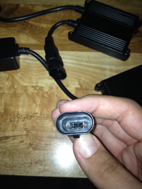

I recently purchased the DDM HID Kit, 35W, D2S, 6000K Kit and also the D2S adaptor cables because I had a ballast go out on my 2004 tsx. I was planning on using this kit to replace my headlights and then broken ballast instead of paying 100 for a new ballast. What I purchased can connect to the headlight but I'm not sure how to connect from the ddm ballast to the stock ballast or whatever. I'm not sure what is supposed to connect to in picture 2. Am I missing a part or something or what? I also wonder why I have 4 connectors that are the same, I don't know why that is. If somebody can help, it would be greatly appreciated. I'm not

pretty sure the only way is to splice into the existing ballast wires/chop off the existing ballast adapter.
or you can just buy a new oem ballast, i have one for $75 :) lol
Buying a new one is the easiest way but ^he is right you have to splice into the factory harness to wire the new ballast.
