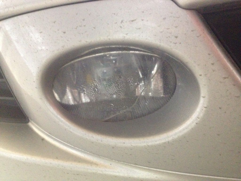

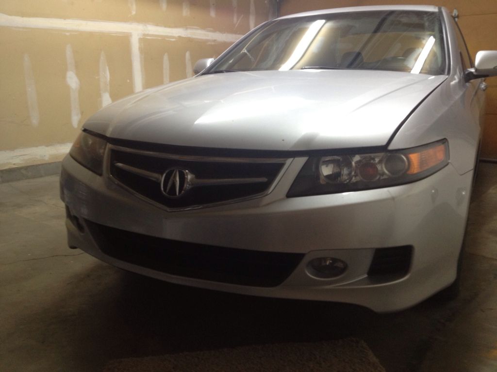

We will be replacing this....

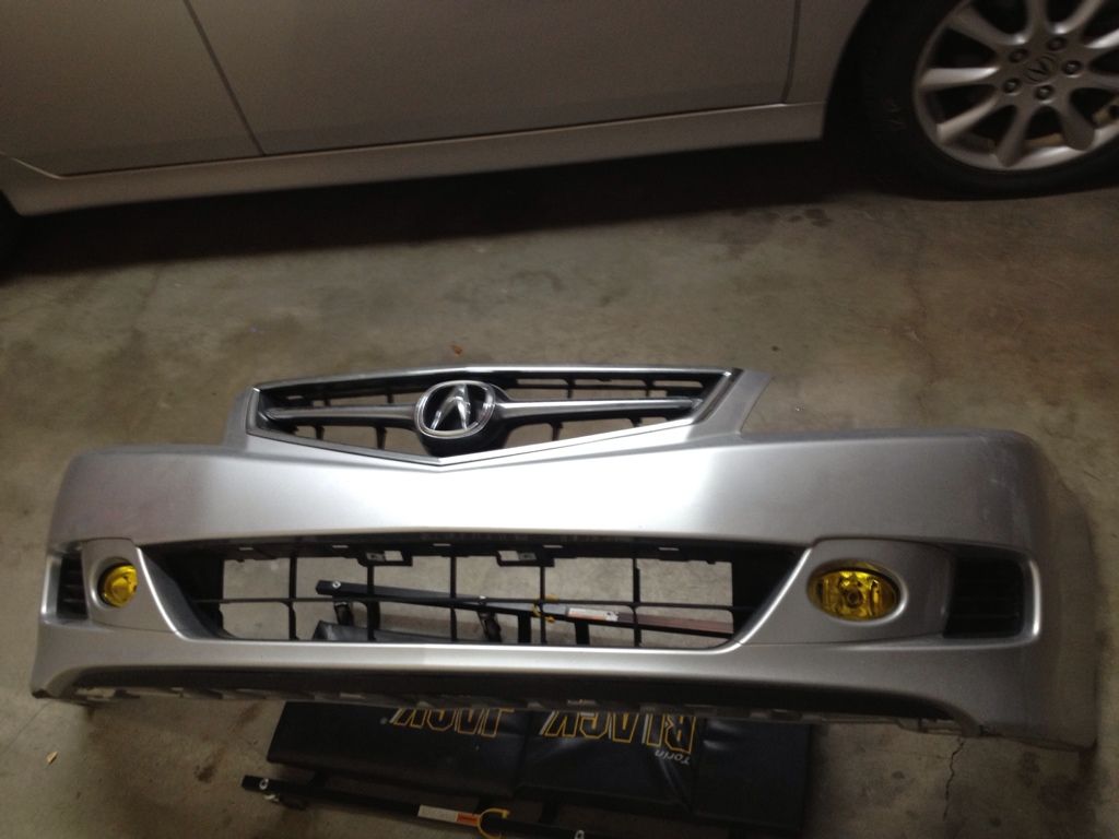

The TSX foglight is obviously a little bigger but heres a quick mock up on how well the RSX foglight will fill the hole in the bumper

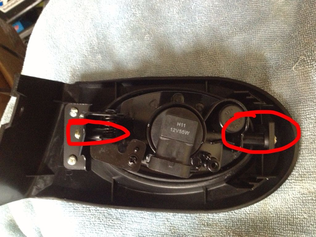

Again the mounting points are similar but the RSX length is a bit shorter. Note the spacers used in the RSX bracket, PURPLE is a HARD plastic spacer and the BLUE is a SOFT rubber spacer. We will reuse these when mounting to the TSX bracket

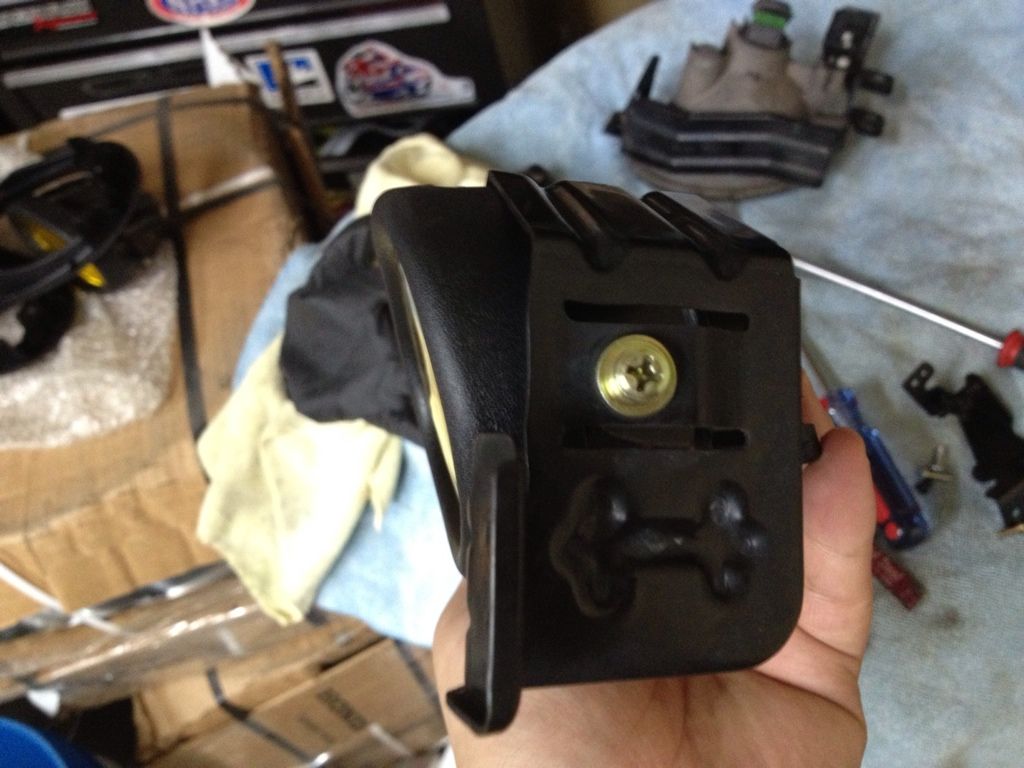

So you will detach the foglights from their brackets by removing the screws on the side and the adjuster screw on the back
Here on the INNER side of the foglight we will use the screw from the RSX bracket and the RUBBER spacer that was noted as BLUE in the previous pic placed on the OUTSIDE of the bracket
Here on the OUTTER side of the foglight we will use the screw from the TSX bracket and the PLASTIC spacer that was noted as PURPLE in the previous pic placed on the INSIDE of the bracket

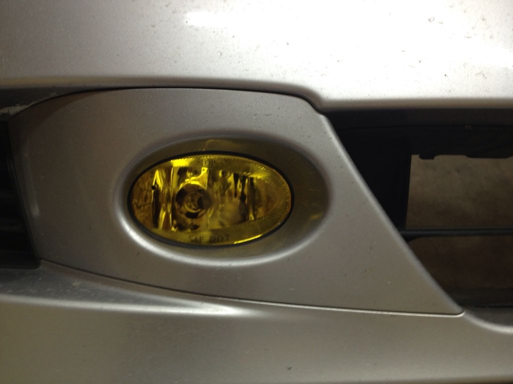

i didnt take a pic of it all done but heres kind of an idea how the fog will sit.

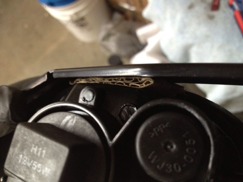

Now about the Con of no adjustablilty, from this position, the foglight will only point down. to prevent that, stuff some cardboard inbetween the foglight and bracket like so. foglight should not move.

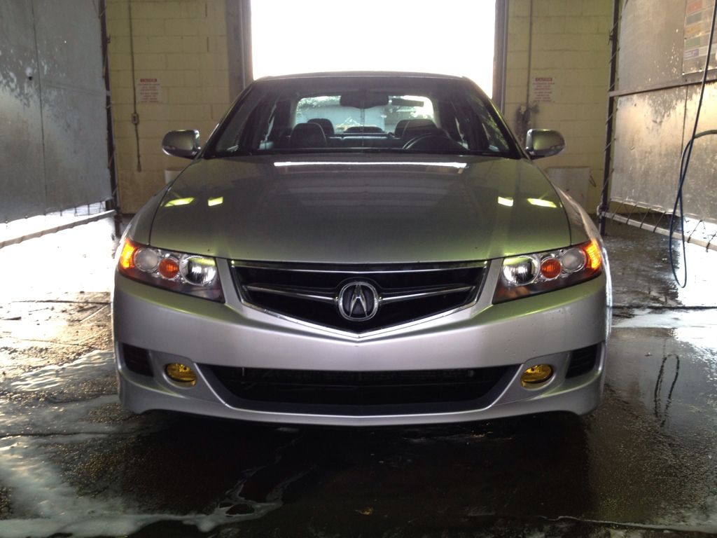

now mount the fogs to the bumper. BAM!!!

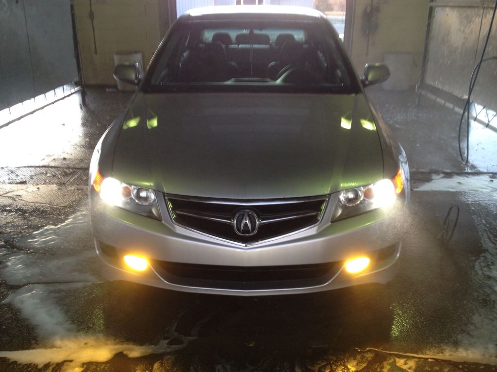

Hawtness on a budget!

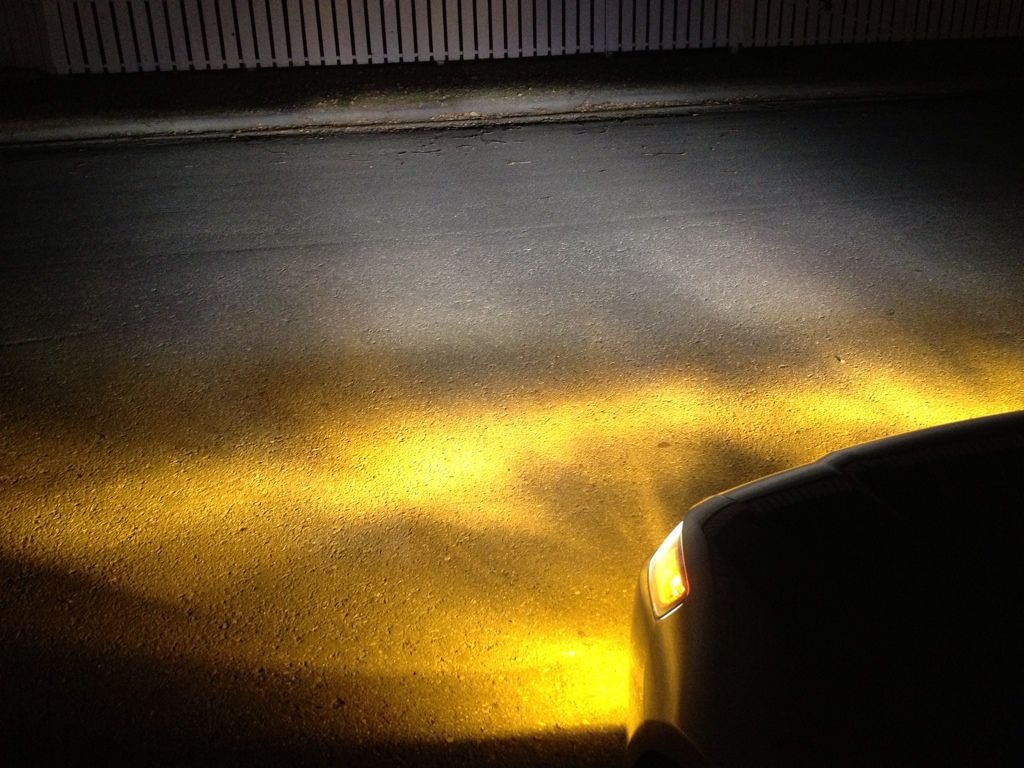

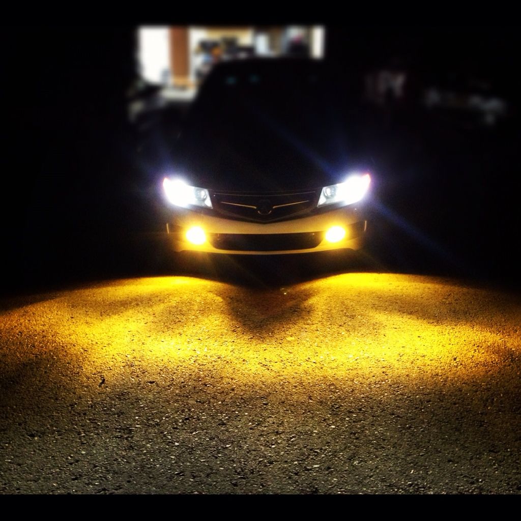

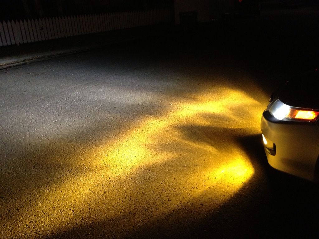

and some night shots with my bumper slightly angled to the the ground for emphasis on the yellow
Now i agree theres probly afew things here that i can go back on and make better but i just made with what i had. Comments welcome! +/-

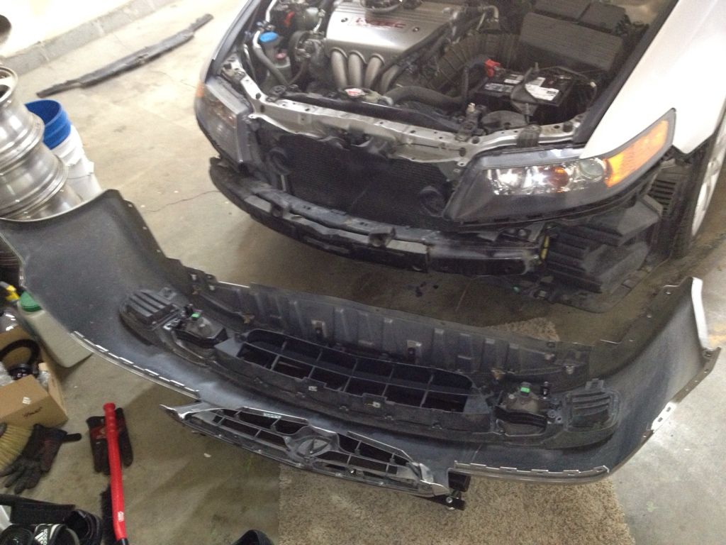

Sooo off with the bumper
Off with the 3 screws that mount the foglight bracket to the bumper

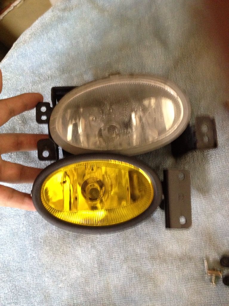

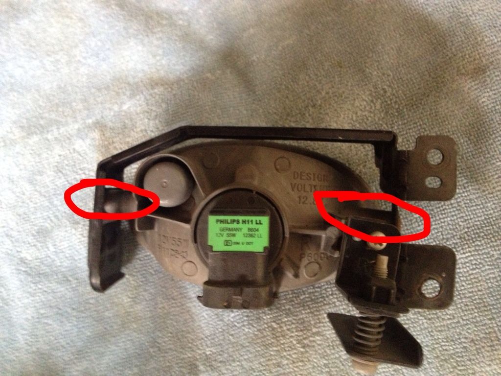

Lets compare..

Comparing the RSX brackets to the TSX brackets, there just no way it will work. But the foglight housing mounting point are about the same for both fogs.
