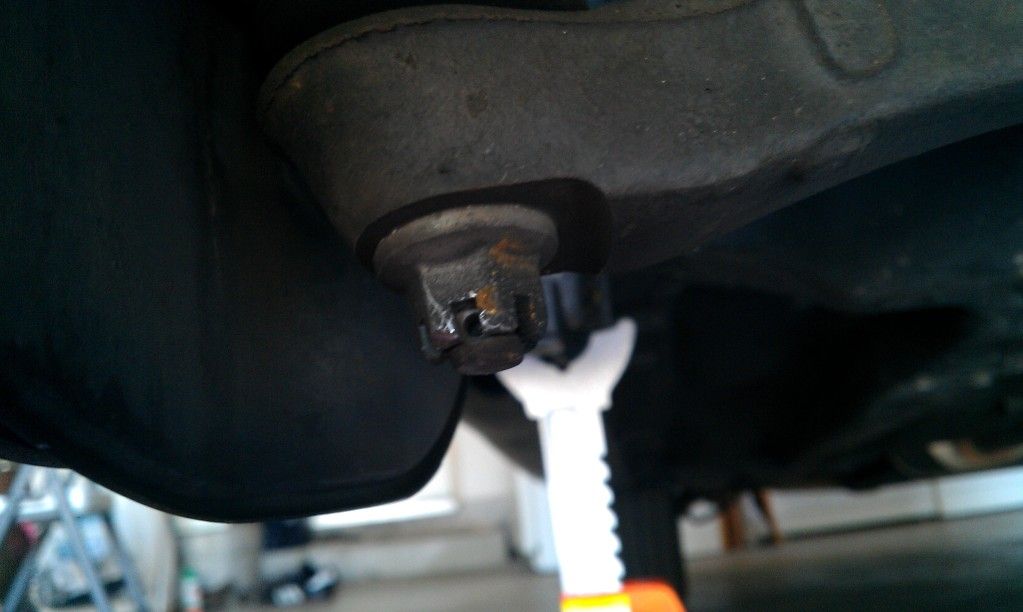

Step 5 Remove cotter pin under lower ball joint with a pair of pliers and remove castle nut with 17mm socket
Step 6 Challenging part for me was releasing the lower ball joint from the assembly because its tapered into the arm. My method was taking my hammer and beating the side of it to break it loose. You can use a pickle fork or rent the tool to remove it also.
Step 7 Remove the wishbone or fork with you're 17mm box end wrench and 17mm ratchet. This will give you space to take it out
