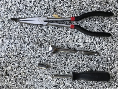

Tools Needed:
1. Flat Head Screwdriver
2. 10mm socket
3. Socket wrench and/or socket driver (smaller may be better)
4. 90 degree pliers (available at AutoZone or similar)

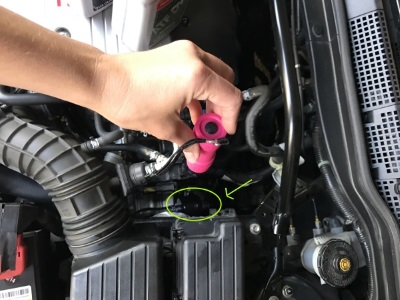

Locate automatic transmission filter.
(Yeah… I borrowed my daughter’s flashlight since mine needed charging)
