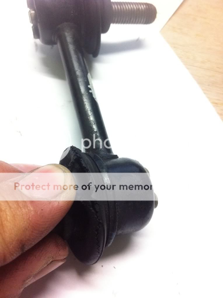

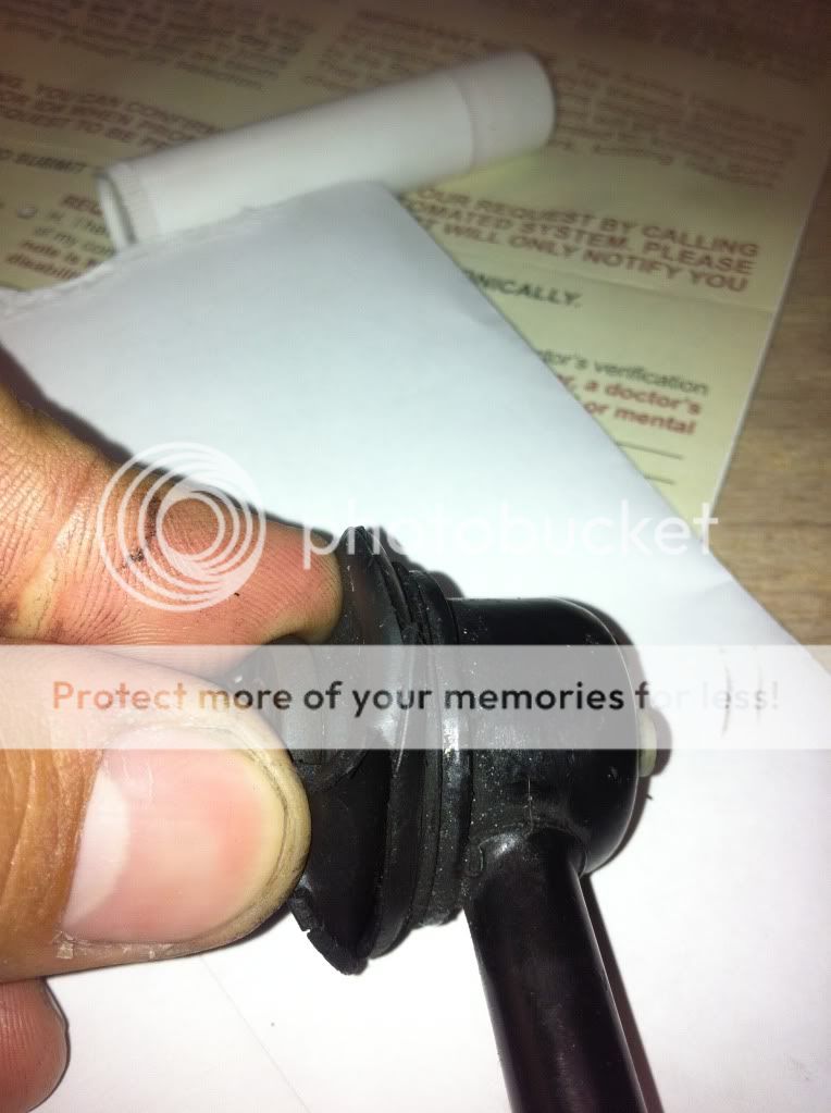

Hate to say it, but torn boot = replace. Once dirt get the joints...it is all over.
From Nissan to Honda
2,170 Posts
If you can adjust either of the balljoints (aka move the direction of the bolts on either end) then you need to replace it.
My car, the clunk was so faint and happened in frequently...jacked car up disconnected endlink from front sway bar and could use my thumb to adjust the orientation of the ball joint with minimal force...
got the new one and it took a bit of effort to move them so it would align with the hole for the swaybar. Thats when I knew the oem ones were shot.
Since theyre off, might as well replace them.
