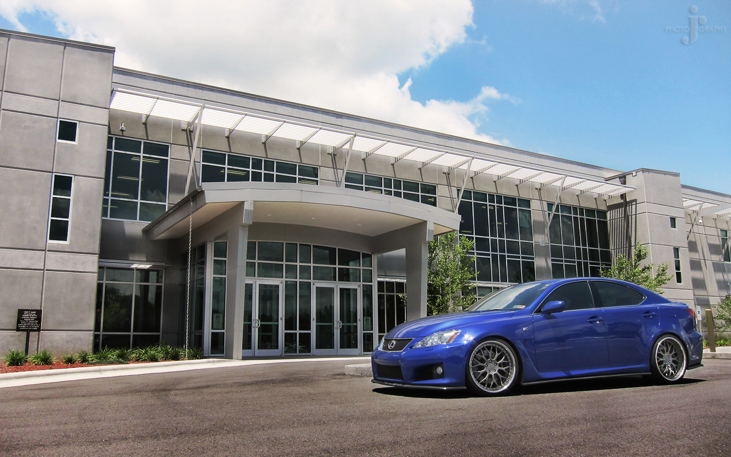

First pic is from a while back just hadn't posted it in here yet. Second pic I just took recently while at home in PA. I included two edits of it cause I can't decide which I like more.
