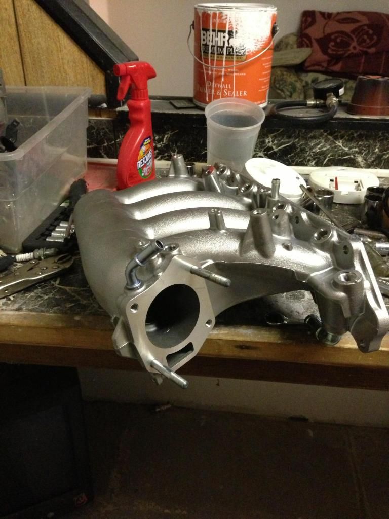

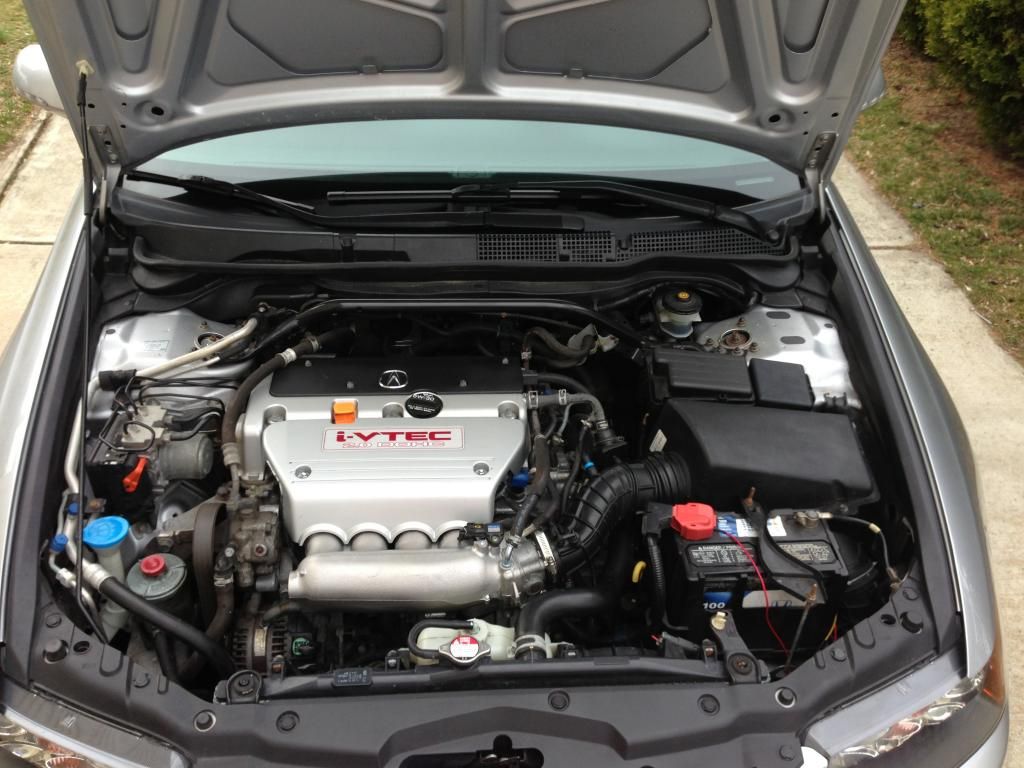

I got around ti finally throwing my rbc on the tsx. Its pretty easy and simply. Run one t fitting no need to drill. The only problem I ran into was first start I had a huge vac leak I didn't know where until l I found that my 06+ p2r gasket was causing a huge leak. So i put the 04 gasket back on and it works fine. I can definitely feel a huge lose in torque below 3500rpm but man once in the upper rpm and vtec the car hauls ass!

i bought an RBC first was not satisfied with how the throttlebody matted up to the rbc.
in my mind it did not sandwich the gasket properly to cover the idle control which is where you had your leak.

I have the 06 tsx throttle body it's big enough for now. I'm gonna save up and get o6 ecu and go flash pro. T fitting is on the side for the line that goes to engine mount. As for now tuning wise car drives fine like I said in upper Rpms car pulls nice a good increase in power. I also have the vtec controller on it so I lowered vtec to 5.
