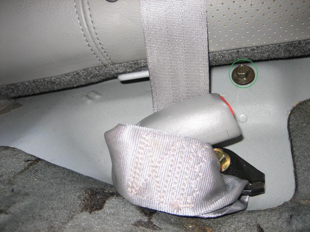

yank the bottom of the rear seats and it should unsnap. then it is a bolt or 2 for the vertical side piece closest to the door
Thanks man! Ended up tackling it after work today. Yes as he said yank on the front of the seats, they snap out. The seat itself is held in by one 10mm bolt located toward the right (drivers) side near one of the car seat latches.

Here's the 10mm bolt I was talking about on the right side, circled in green close to the latch attachment and seatbelt:
