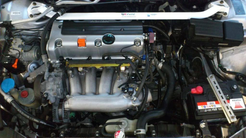

its looks like this today.
just need to get some hose and make up the intake now.

yea ive got the P2R gaskets :)
Mine doesn't look like that..
why? what is different between this and yours?
Why???
Apart from the intake piping not being present.
