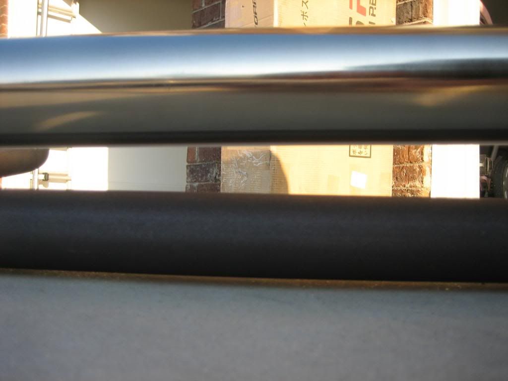

As in the pics below, the exhaust tips are just a tad bit bigger than stock. Stock measures 3 5/16" while SRS measures 3 7/16".

Stocker diameter
SRS diameter

This piece is quiet compared to other exhausts, but just too loud for my taste, so I took it off today and will be selling it shortly. When I swapped back to stock I took some pics to compare. It is slightly larger diameter than the stocker as you can see below:
I did feel a few hp in the butt dyno but not much.
All in all, this is a great quality exhaust for the money, fitment is great, sound is nice and deep, no rasp at all. Just too loud for my taste.

Another thing to note, I did gain some MPG with this on, my low fuel light came on about ten miles later than usual, and that was with the SRS exhaust on for less than half of that particular tank. I'm thinking this piece will add about 1 MPG. It makes sense, the pics above clearly show that the exhaust is bigger and therefore allows more flow.
