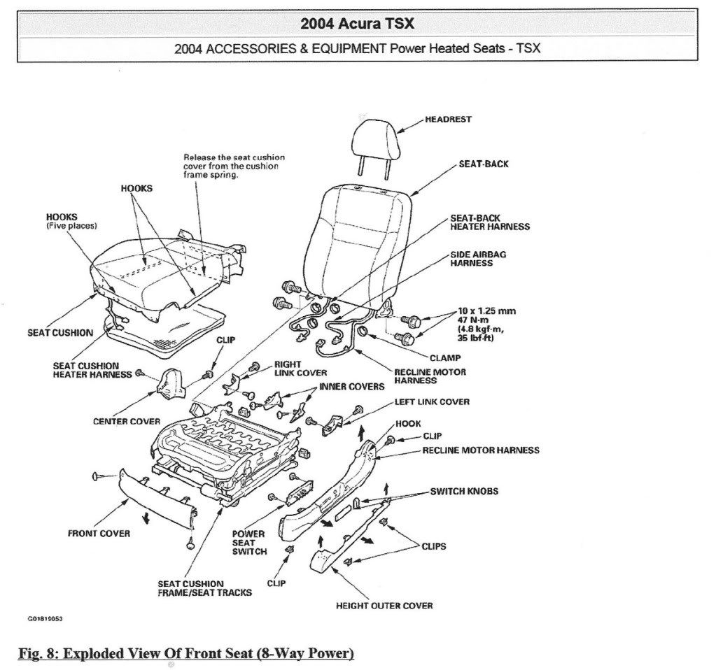

Step 2. I removed the left lower plastic seat covers holding the controls. There are various clips holding this in place. No screws/bolts. 1 push pin in the rear.
Step 3. I removed the front plastic seat cover. There is a Philips screw located on either side at 45 degree angle. Once they are removed, the cover has three plastic hooks if you will. They are tricky but easy enough after observing the curvature.
