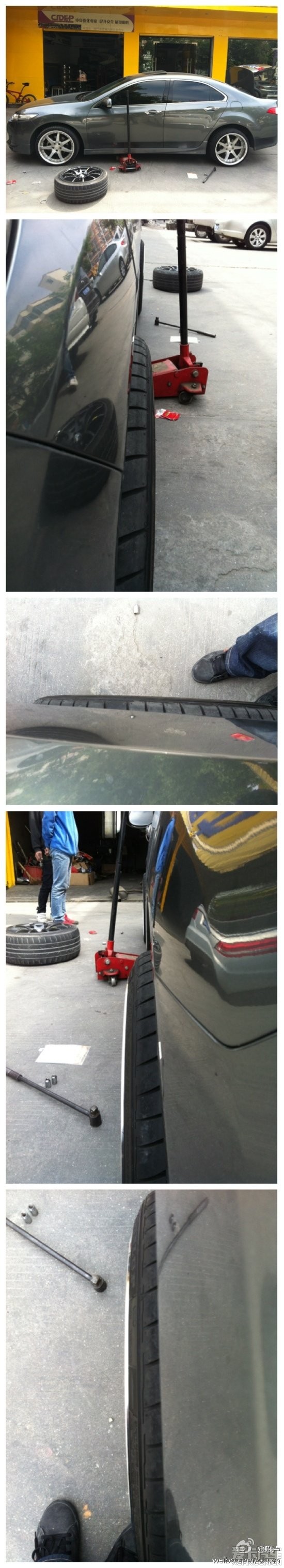

The tire will be 245/35/19 because the bad condition of the road. I have broke 4 tires a year when I use 225/45/18.
I have tried my friend's work GS3. They are 19*9 +25 in the front and 19*10 +20 in the rear with 245/30/19.
In my car it comes out for half inch in the front and 1 inch in the rear.
So I think 19*9 +35 in the front and 19*9 +40 in the rear will be all right??
the reason they poke so much is cuz you have no camber lol, are you planning to lower it? if yes then it sink in. but you will still need a roll with your friends specs. and for the specs you mention, i would go 19x9+35,19x9+30 if anything
