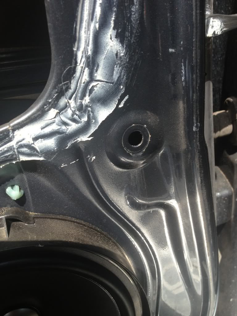

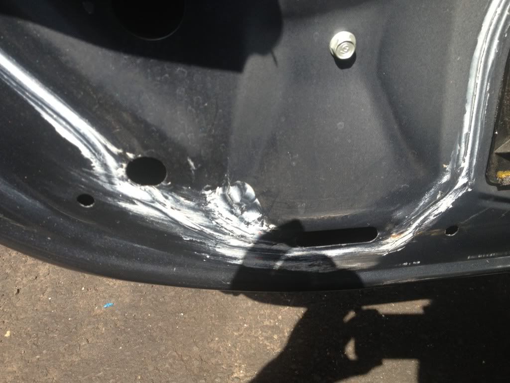

Hey guys, i been getting some puddles in my car and doing some online searches and research. Found basically that people were seeing a leak coming from within the door panel. So i got the chance to take it off today and behold i find what there talking about. There is a sticky, butyl tape, like glue that holds a moisture barrier that keeps water in the door. From what i found, its actually coming from the small holes on the outside of that plastic where the pushpins from the panel push into. i was able to reseal the plastic and apply a seal around the holes where the pushpins go into. i havent been able to test it yet but here are some pics of what im talking about...
in the last image you can even see trails of the water drops.

I don't suppose you could highlight for clarification? I'm at my wit's end with water in the rear floorboards. I suspect I may have a similar issue. Were you able to verify a fix? All I have read is that it has to do with the plastic liner not properly sealing the door to keep the water from flowing into the cabin. My problem is that I'm not certain I see the "paper trail"

I would've been too and I can't tell you how close I am to getting rid of mine. It's been a year almost to the day. But I think I found the problem. It's the door seals for me. There could've been a flood last night with all the rain we got. I found water inside them and under my audio wiring. I'm going to replace them all. Just odd that the space under the wiring never left a trail of any kind. I really hope this is the end of it for me. Not sure if the dealer even checked anything at all. My trunk and roof drains checked out clear again for now.
